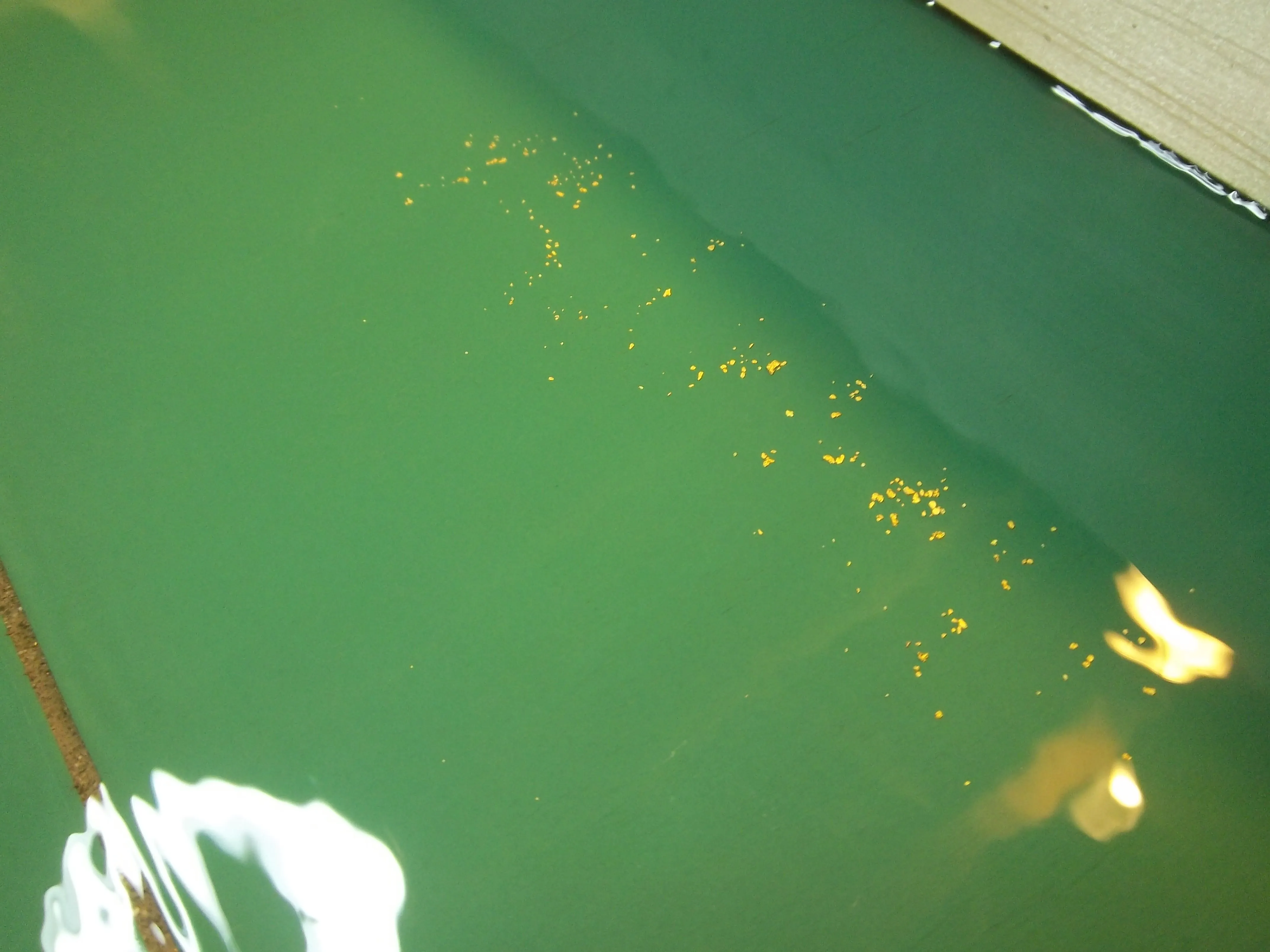

Are you happy with that paint? It was one of the possibly surfaces i would use, I think i like the green color, rather than black.
Two years later.......and a lot of use (w/ thousands of gallons flowing over it)..... the paint has held up great w/o any problems :) 003.webp
