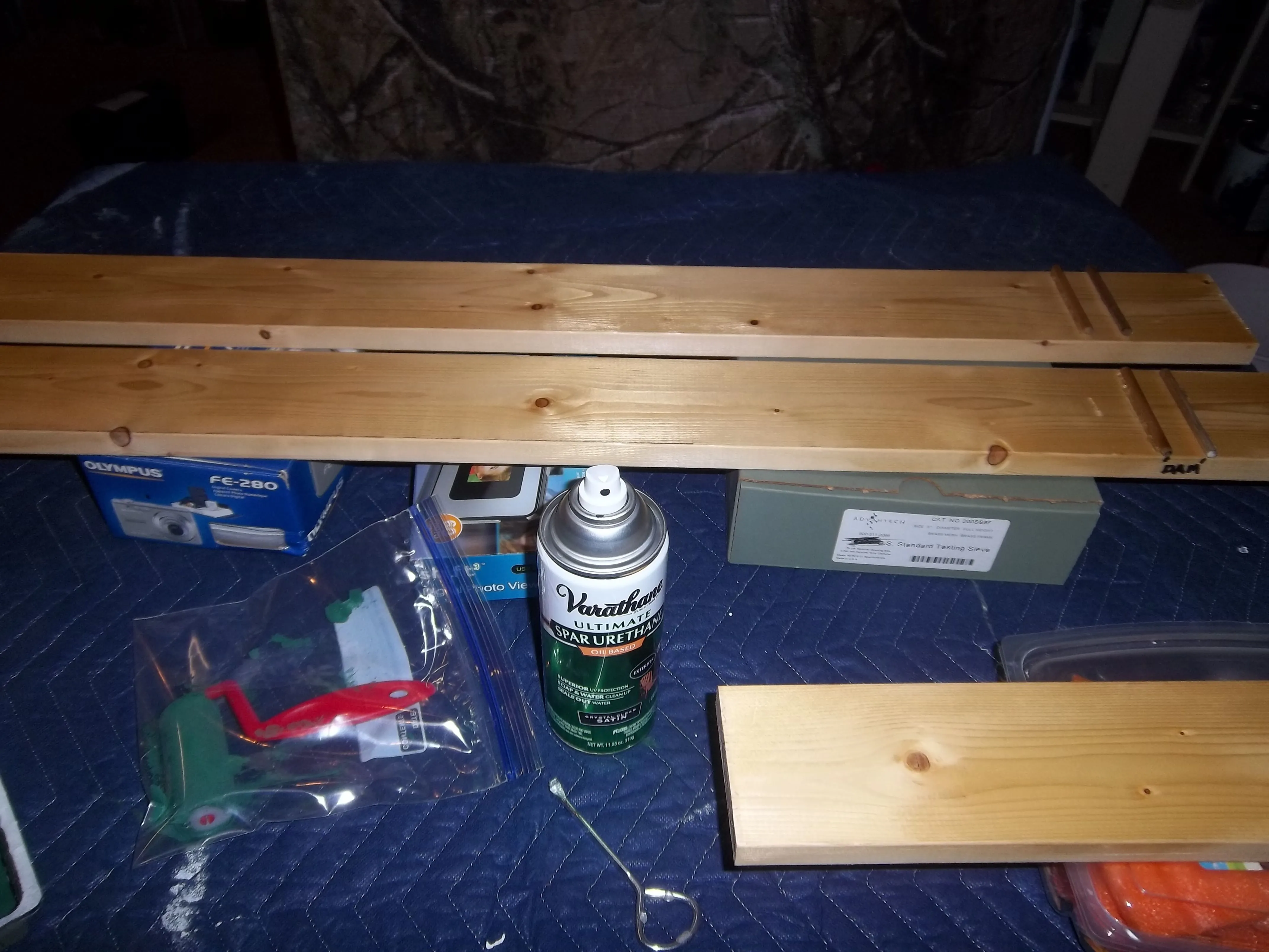

003.webp different view while being built
In the beginning i changed the height often to get it correct,But i don't anymore. So you could probably skip that .Cause now the 'proper height' is known.FOR this particular table & pump combo

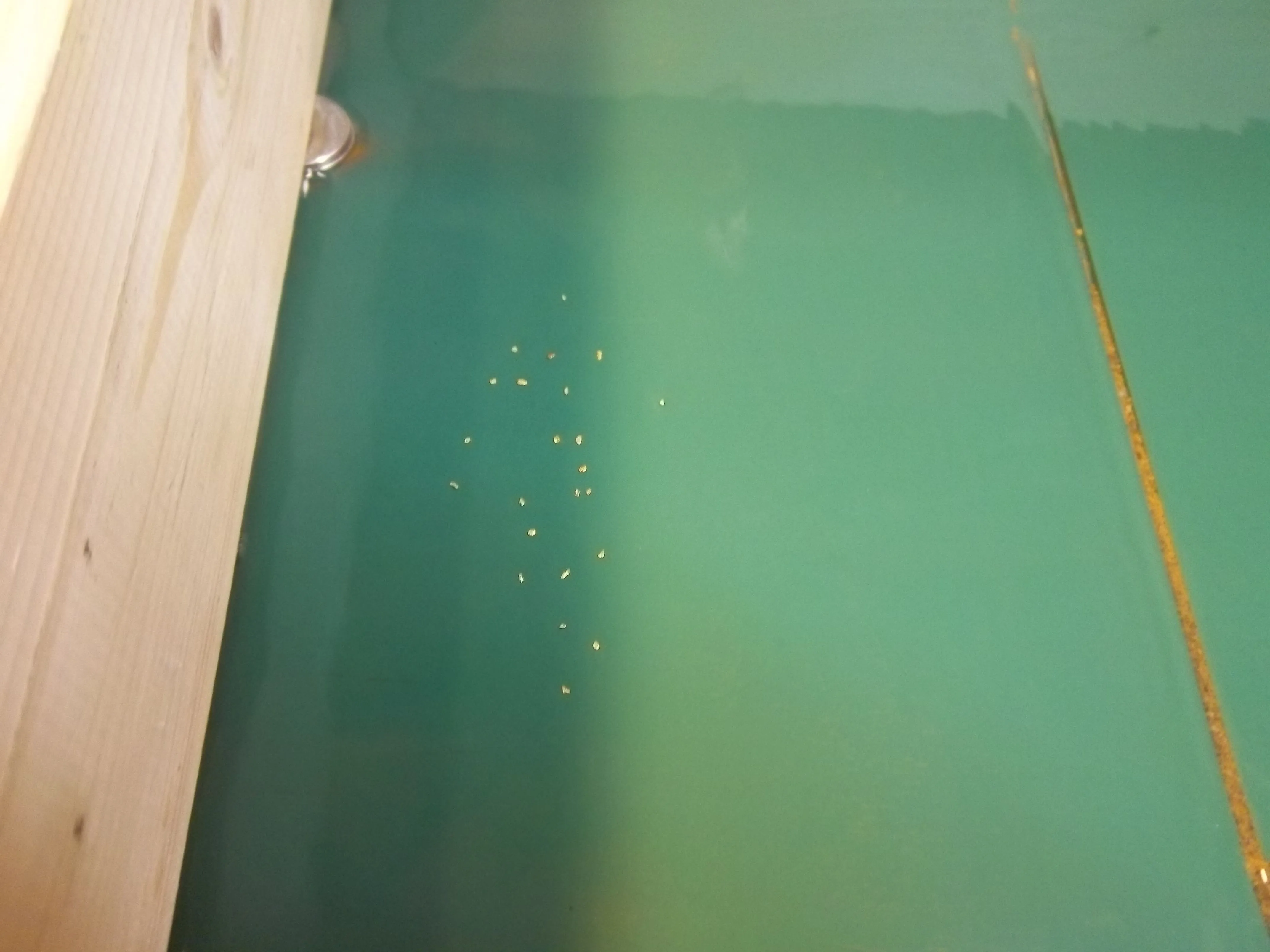

A#1....Also don't forget the 'slot' on the table.Its the width and depth of a table saw blade. About 8" downstream from the Dam.It will catch all the small gold.

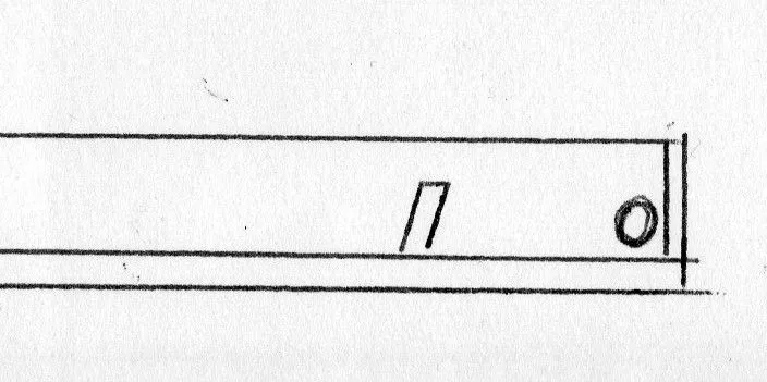

In the type of reservior/dam system you speak of....What dam height would you suggest?
Or could you perhaps give a photo or illustration of it?
I understand the principal of what you're saying, but not quite how to build it yet.
The dam can be about 1/2" shorter than the height of the walls since the flow down the table during operation will always be less than that. Bevel the bottom so you can install the dam slightly slanted backwards so when you tilt the table the water will still flow down the dam rather than free falling. If you don't bevel then just make sure the high point is still at about 1/2" shorter than the sides when installed and fill the void at the base.
I like the slot, do the sands clear out well enough?

Something like this? With say, a 1.5" wall, and a 1" dam.
