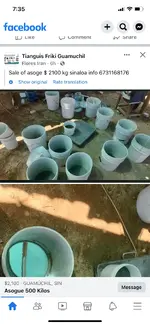

I found a guy selling mercury in Mexico…I just might break down and buy some one day…
Ed T
Ed T

I remember when I was a child…We used to break old thermometers and tv tubes to play with the mercury…
The guy I found selling it in Mexico is only asking $2100 pesos per kilo…And he states that he has 500 kilos for sale…He was offering other mining equipment as well…I believe that a kilo of mercury will probably last me a lifetime…

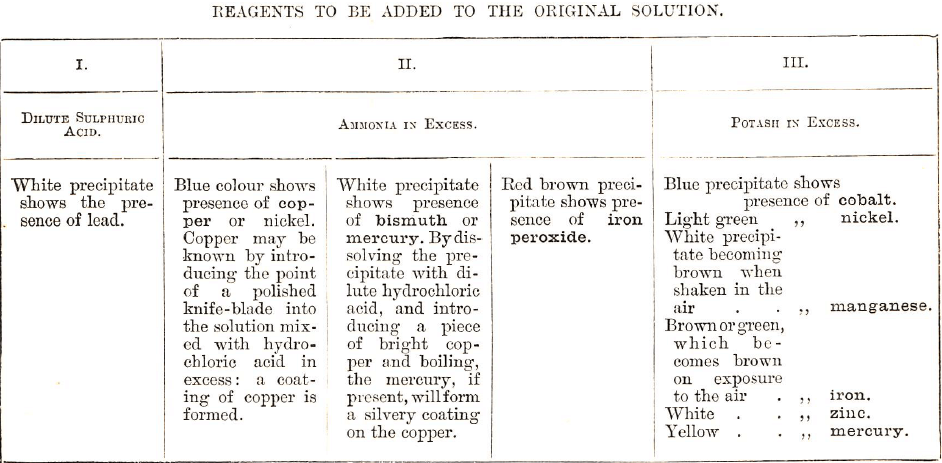

Here is a link some might find informative…
Ed T
Ed T
It seems like nobody can be trusted in this day and age…The link I posted states aqua regia as a 4 to 1 ratio…I believe it’s actually a 3 to 1 ratio…And I believe you can use this…https://www.walmart.com/ip/Pro-Cure-4-oz-Sodium-Sulfite/44818055 or https://www.ebay.com/itm/1523491126...KnmLtM1l+7OIv6ASvof8RNPbqBan|tkp:BFBMhPnej-Bh to drop your gold…Those who are interested can read up on it…
Ed T
