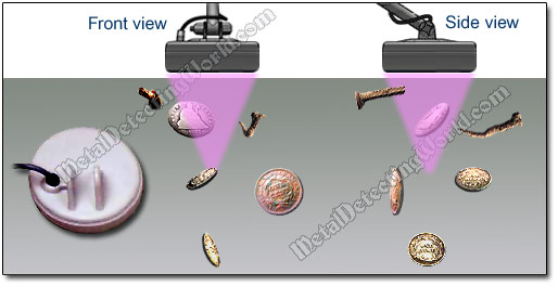

Hey Digger, that old horse used a "stacked", AKA "tri-planar" search coil, and seriously concentrated, that's why it went so deep. However, those had a very narrow field of transmission, very centered, very confined. But more research engineering is bringing them back again..
) Coaxial
This search coil design has identical diameter transmit and receive windings stacked and aligned on the same axis: the transmit winding is sandwiched by two receive windings in near perfect alignment on center. This creates an electromagnetic detection pattern of more uniform density and performance, and offers the best resistance to interference from high-voltage power lines. The electromagnetic field detection pattern of a Coaxial coil is also cone-shaped.
Because of its specific design, this type is seeing renewed usage only in smallest coils or "mini coils" of 4" in diameter. It would be impractical to use the coaxial coils of larger sizes due to unavoidable increase in coil's thickness and weight.
This type of search coil produces an opposite reaction topside compared to the bottom when sensing a target. If you have the habit of passing a handful of dirt over the top of search coil during recovery to verify whether the target is still in the hole or not (as described in "Plug-Splitting Technique" on "How To Metal Detect" page), you should not do so when using a coaxial search coil.
If a target is accepted on the underside, passing the same target topside will make no sound. The target hiding in the dirt in your hand will seem to "disappear", further confusing your recovery.
Coaxial Search Coil and Its Electromagnetic Field Detection Pattern
