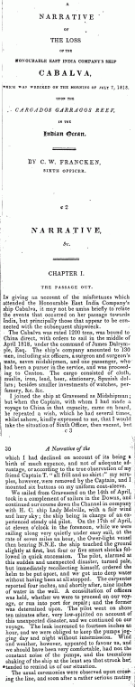

The Cabalva was carrying some lead cargo when she wrecked in 1818, but its a long way from nowhere to the wreck site. The divers used pieces of the lead cargo to hold their position in the coral gullies from the wave surge while recovering pieces of eight.

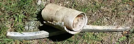

you guys might find this interisting, i found this old lead with the birch bark and some coins dated 1624. I think the lead is for lead seals.some glass also came with it , cant find the peice, yet.
