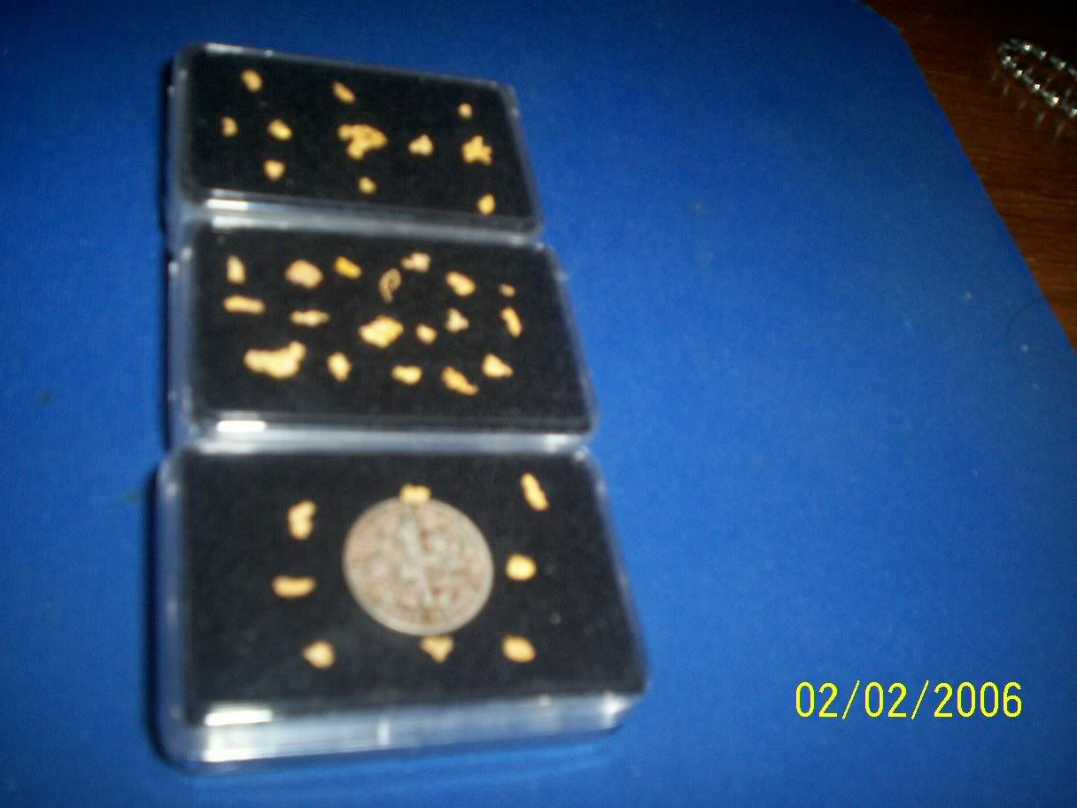

fsa, I just went through the same decision making that you did and ended up with the Minelab Eureka Gold, also. I've had it out several times so far. A couple of times in the back yard with some gold nugget samples and coins and once in the mountains, trying to find a nugget.
It's almost a "turn on and go" machine, but it'll take a bit of playing with in order for it to see small gold. I've gotten down to a .15 gram nugget at about 4" in the 60 KHz mode in tests using the stock coil. Did you get a good set of headphones??? That seems to make quite a bit of difference when trying to pick up small gold signals.
