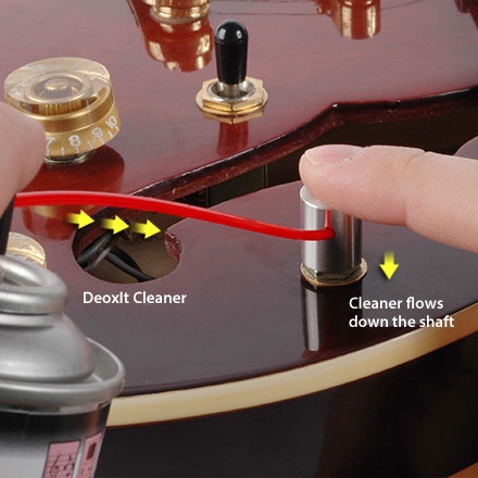

Look at this fancy smancy pot cleaner
The cleaner/lubricant that is used on guitars and amplifiers will do the trick. WD40 will clean with no real lubricant and can become worse after awhile.

The pot cap shown may be the ticket for cleaning without disassembly.. Thanks!
Good info Rusty. I had thought the dry cleaner is what I needed.. Now I understand I need cleaner/lubricant..
