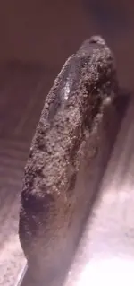

I'm sure Conservator may come back with something but I made the decision to proceed with the task at hand. After reducing the solution and soaking the coin for 13 hrs in fresh water alone I put it back in the machine for 5 hrs tonight. I just pulled it back out and rinsed it again and it will soak overnight in fresh water
WE HAVE A COIN​
The edge is visible in these pics and the metal appears to be stable and holding its weight. Also a slight shine was present but not sure if the camera picked it up. I am real happy about this, here are the progress shots.

Another note is this is the larger piece. I still have one of the small ones intact but will discontinue work on that until we have completed this one to its final conclusions. Here are some more pics

Re: THE GREAT SHARK PIT COOKIES CLEANING EXPIERIMENT
It does look like silve,r doesn't it.
Very exciting post!
