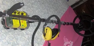

Here's one I built...... Straight shaft for Beach Hunter ID
there easy to build..you need 3/4" aluminum pipe,the adj pistol style grip comes from a bike shop...the rest of the parts are salvaged from factory shaft.

Beach Hunter has made the best straight shaft for the BHID!!! However, There's a detector shop selling custom shafts for the Garrett Infinium and the Sea Hunter as you requested. I sent you a PM about it.
Thanks and HH!!!
Hey Beachhunter That looks really good , Can you tell a big difference from stock setup??? I might want to do the same to mine,, Guzz1
