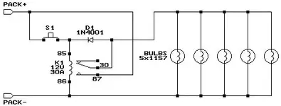

I suspect your rechargable battery pack is shot. The reason you are seeing such a low voltage across the battery pack terminals is the internal resistance of the battery pack increased from multiple overcharging of the battery pack. Sometimes the battery pack can be rejuvinated if you fully discharge discharge it and recharge it to its nearly full capacity by using a slow charge. It is safer to charge a NiMH or NiCAD pack at 10 percent of a battery packs charge capacity. That means that if you have a 2000mAh pack you want to make sure to charge it at 200mA of current for no more than 16 hours. Try to build a discharge circuit that I have provided and do a full discharge on the pack. In reallity you should do a full discharge of the battery pack after every use.

When you overcharge a NiHM pack what happens is the internal plates inside the cells start producing a gas that causes the pack to heat up very quickly and causes the plates to " Sulphate " preventing the pack from reaching its full charge. But in your case you say you charged up the pack only once it sounds like the charger isnt properly matched to the battery pack. The charger should produce around 16-18Vdc when the charger output isnt connected to the pack and should drop to around 12.5-14.5 when you connect the battery pack. The battery should be charged with about 100mA and the power supply should be close to that current rating as well (100mA). Thats why I have a Spectrum XLT with a NiHM pack that has over 7 years and still using it. The pack dropped its total capacity from 100% to about 88% but i fully discharge the pack after every use with the circuit I provided above before I slow charge it.
