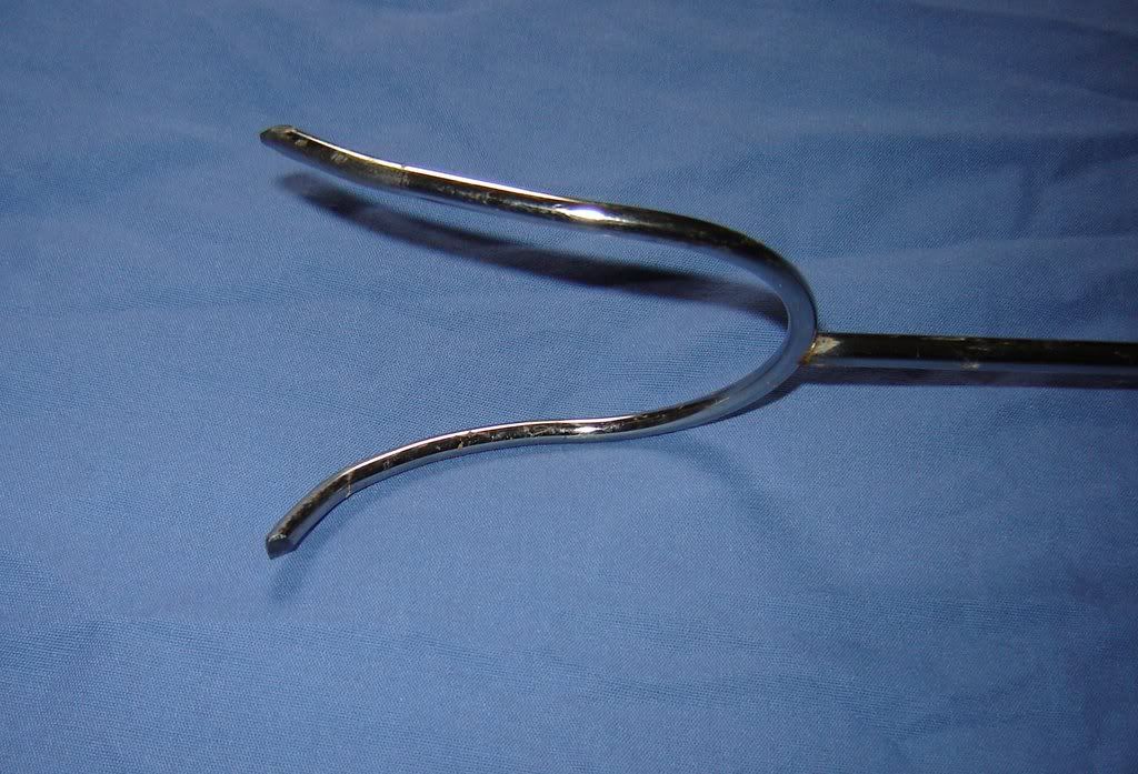

This is a simple recovery tool that works best in wood chips. When using it, I
usually donāt have to bend over except to pick up the target.
It makes recovering targets in wood chips faster and easier.

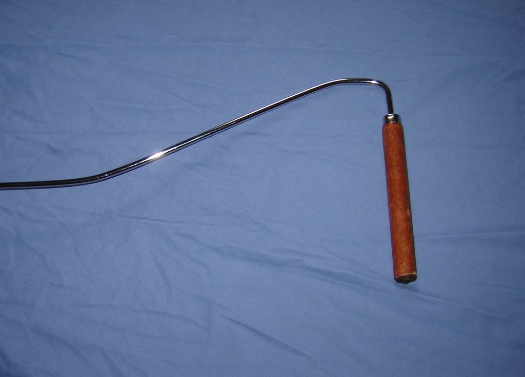

You buy a Camp Fork at Wal- Martās Sporting Goods section for $2.97.
Cut about 3ā off the two ends of the fork. Bend the fork ends in a slow spiral
as in the photo. Bend an 80 degree angle just below the handle. Make a slight
bend below the handle as in photo.
Now you have a genuine Arkie Barkie Twister.
Check out this short, un-rehearsed video.
http://s220.photobucket.com/albums/dd296/dcb1265/?action=view¤t=BarkyDemo.flv
After recovering roughly 3,000 targets, the thing started to bend a little. It
still works though.
I never wore one out, but I've lost a few.
It wonāt work well if there is a lot of roots in the wood chips. That's what
caused mine to start bending.
I have been using this tool for about 10 months now. Iām still sold on it.
It saves me a ton of bending and squating. Also speeds up recoveries a lot.
Hope you enjoy my idea.
