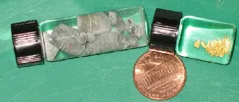

Surfin',
I was going to email you some pictures of more OH gold, but couldn't find your address. At any rate, here's some gold and other metal I found (lead) the last time I went out up in OH. Hope you find some, too!
Lookin'
