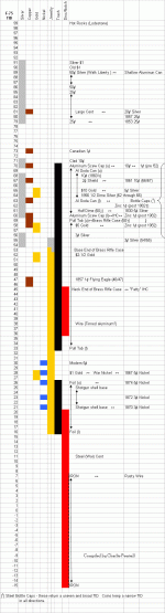

Turn off or way down the discrimination. And remember that old silver is deeper and probably reads lower than you expect. Forget the icons that the detector displays and concentrate on the sounds and readout. I made up the following chart by ground testing pattern coins with my new Fisher F-75. (The gold coins are estimated - the next gold coin I find will be my first). This won't apply to other detectors, but the relative position of coins along the scale should be representative.
