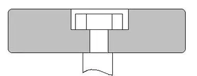

Maybe if you countersink the pointy nut on the push rod beneeth the surface
so you could use two hands then push the plunger with your knee?
Maybe even use an old rubber hockey puck so it's not so tough on the knee too.

You have to use the plunger on the surface of the grass, its too much force to pull against the knee.
I would have countersunk the top part but the collar clamp has a hex nut on the side of the collar that has to be accessed to tighten it down.
In the future I may tap the top of the plunger rod so I can screw a bolt directly into the rod itself.
Thanks for peeking and the graphic WG!
