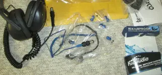

On the 3030 m12 connectors they sell a bushing kit to fit several different size wires, from 2mm to 28mm. I did several sets but no longer do any work, the sets I did do lasted a few years from the feed back I got. One other thing that must be done when using the 3030 m12 connector is to fill with epoxy to seal the solder joints just incase the seal should leak. This guarantees no issues with the m12 connector internally.
View attachment 1344397View attachment 1344398
Wow that looks really good. So how does one get into the inner sanctum to order such a thing.
