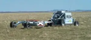

Vehicle mounted metal detectors are used all the time in unexploded ordnance detection and discrimination surveys. One example is MTADS which is run by Blackhawk which is an array of either magnetometers or Geonics EM61-MK2 units pulled by a non-ferrous dune buggy. The EM61 data is logged by a modified version of Geometrics MagLog software concurrently with the GPS data. All the data is processed later using Geosoft's Oasis Montaj software.

On the issue of instrument interference, the multiple EM61-MK2 units on the MTADS array can be phase locked with a trigger cable. You could also try a GEM-5 from Geophex (www.geophex.com) which has a large Tx coil and five pairs of gradiometer Rx coils.
