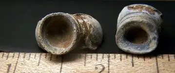

Just how can one tell how old a bullet is? You would think I would know that by now. :P
Like I found two of these bullets today...
You see those little lines inside the rings? Does that mean these bullets are not that old?
And the size of the hole in the bottom? Does that mean anything?
Thanks! ;D Nana

I believe you have two fired minie balls. I also believe that if you had a mated pair that hit each other in flight and were still attached you would have a very valuable find. congratulations, siegfried schlagrule
I must disagree. These are not minieballs. They are more modern.
-Buckleboy
stoney56
Oct 4, 2004
6,888
56
Oklahoma
I have to agree with Buckleboy on this. The knurling (diamond pattern) is used to hold the bullet lube. It's about twice as effective as a regular groove. Picture a pancake w/syrup vs. a waffle with syrup. ;)

Hey! Thanks ya'll! :)
OK...next question... ;D
Knowing that these are 'not that old'...how old is 'not that old'? When did they change?
Last question..bear with me here...I'm learning... ;)
Keeping in mind that CW bullets had no lines in the groves, I am supposing that the groved lined ones were next generation? And after that model, were these?
Lines going up the sides....
Thanks for the info! :) Nana

Nana, I'm not a ballistic expert but if you're refering to these lines (see pic)...those are rifling marks. The rifling grooves cut into pistol and rifle barrels to cause the bullet to rotate while traveling down the barrel and give the bullet more stability and accuracy. Someone else might be able to tell you what manufacturer made those based on style. Each manufacturer had their own unique style, Winchester, Colt, S&W, etc.

Old Garrett Deep Seeker
From the size and the cannulae on the projectiles, I would suggest that there are .38 caliber hollowbased wadcutters. If you weigh the lead it should weigh between 140 and 160 grains. This is a usually a target round that has a flat point that punches nice clean holes in the paper target. As to the age, the bullet design came about around the 1930's ~ 1940's.
