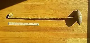

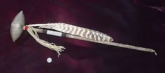

I was going to ask about drilled holes! I want to share some up close pics and get some feedback...supposedly an 1890's ceremonial piece or more likely tourist piece. Plains Indians. Is this 1890's style or later? Thanks.

Bad pic...but you can see the drill ridges...seems more modern but not as modern as a mortar bit.

Another try at the pic... ImageUploadedByTreasureNet.com1493138497.698909.jpg ImageUploadedByTreasureNet.com1493138543.771526.jpg
The horsetail, sinew, turkey feather remains are all real...I just think it was either for ceremonic purposes or tourism...my wife bought it for me but I've had suspicions that it isn't what they sold it to her as. They claim 1890's...ceremonial.

I have not ever seen an item like that, not sure what it would have been used for. The ridges in the hole look odd almost like it was molded that way. I can say it was not drilled from the photo. JMO

It almost looks like a stepped bit used for cutting out metal. Definitely a conically shaped hole. I was thinking old, 1890's or so, but probably for tourism/memorabilia. Not sure but others similar to it can be found on the web. I appreciate it.
