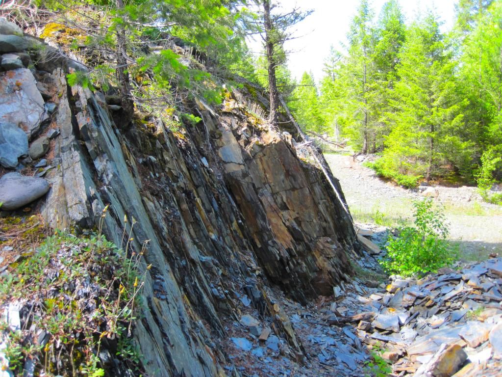

Question to all:
I know what slate bedrock looks like, as I've seen countless miles of it, and because it fractures so easily, it catches the gold well. But I've seen other types of bedrock in the same areas I hunt, and I don't have a clue what type it is.
I'm not sure what the bedrock was that this nugget was found in, unless it's Gneiss? Does anyone have a link, with good pictures, that can help me learn to identify different types of bedrock so I can tell people what kind of bedrock this nugget was taken in?

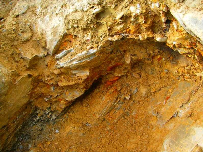

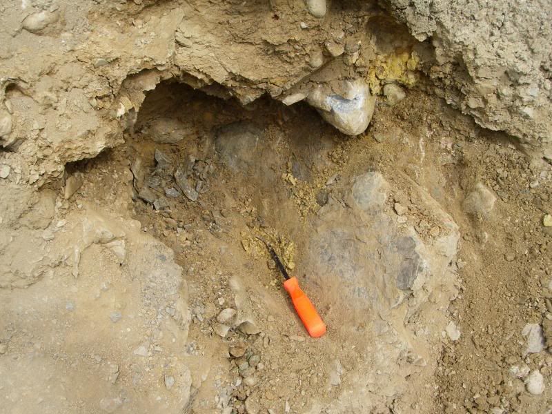

Here's a little tale of some nuggets I found in a hydraulic pit.
I was detecting in a hydraulic pit one day. I was using a Minelab 2100. Moreover, for those of you that have never detected a hydraulic pit, there's a genuine trove of junk that's always left behind.
I was finding little brass boot nails, copper wire, blasting caps, old square nails (of all sizes), drift mine rail spikes, dozer-blade shavings, cigarette package foil, bits of old tin can (AKA, canslaw). . . I think you get the idea--I was hitting everything but gold!
I wandered over to a rise on the side of the pit where there were some quaking aspens. It was a hot day with a cobalt sky, and the shade looked inviting. The unforgettable smell of the pines higher up drifted through the pit on its random journeys.
I sat down and pondered what I'd been up to. The pit was huge, and I'd been hammering the exposed bedrock, and any places where there was a clay deposit tight on the bedrock. I guess it was good that I'd been finding the junk, as it proved the area wasn't totally hunted out, but I wanted some gold. I was tired of my world-class assortment of junk.
As I sat in the shade, I noticed lots of river rock around the base of the trees. I looked at the rise and saw there were lots of river rocks tumbled from it as well. I took my shovel and peeled off the surface plants, and underneath, you guessed it, lots more river rock.
I fired up the detector and passed it over the rocks and worked my way along the edge of the rise. To my amazement, I got a signal! Of course, I automatically assumed it was another nail, as there was a veritable nail-mine in that hydraulic pit.
But, for those of you that have used the SD's, the tone was low on the ends and high in the middle, a good sign, generally not a sign of iron, although I've been fooled by the small tips of square nails before, for they really sound like a nugget. I have no clue why, but they will drive you crazy.
Anyway, I dug down and cleared away some of that river rock. I noticed right away that the dirt didn't look like it had been disturbed. It looked like virgin ground, and as I looked at the rise, it made sense. This was obviously a small hump they had left when they were hydraulicing. Why? Who knows for sure, but around the side of that hump there were a million nails, so maybe there was some sort of building there when they were working that stopped them from blasting that place with the water cannons.
At any rate, I kept digging, and the signal got stronger. Pretty soon, about eight inches down, I saw bedrock. I passed the coil over the spot and the sound was nice and sweet.
This was shale bedrock, with lots of fractures packed with clay, and lots of small river stones jammed on and in it. I pinpointed the signal and carefully scraped down through the clay and small stones. There on the bedrock was a nugget. It was very flat, but it looked remarkably like the sole of a shoe, the bottom of a golden Barbie boot perhaps, only thicker, and somewhat larger.
Naturally, I decided to detect the area more, but I got no more signals.
Next came the thing that can stop a nugget hunter cold, the battle over whether to strip more overburden to expose the bedrock. Was this a rogue, loner nugget, or was this a patch that would warrant the extra work to clear the area?
If you're like me, I've faced this decision many times, and many times I've thrown off hundreds of pounds of annoying rock, only to find nothing. But, the place had a feel to it, and the rest of the pit was baking in the blazing sun; therefore, I was working in the comfortable shade, so I decided to tear into it.
As a side note, my buddy invented a slick rock fork that I had with me that day. He took a manure-fork and heated the tines and bent them about halfway down their length at a right angle. Then he cut the sharp tips off, leaving safe, blunt ends. This is a dream tool for raking off river rock from bedrock as it has a long handle, and you can really move the rock in a hurry. Plus, any heavies like gold fall through the tines and stay put, but the rocks get cleared off.
The overburden varied from about six inches to a foot, and the rocks varied from cobbles to watermelon-sized boulders.
At last I'd cleared an area about the size of two half-ton truck beds. It took a lot of work, but there was a nice patch of exposed bedrock. This was once again covered with the clay and the small river stones.
I ran the coil over the area and got no signal at all! I slowed down and ran it perpendicular to the way I'd detected it the first time. This time I got a whisper. I got out a scraping tool and took off the clay and stones and the signal was slightly louder, but still very faint.
I used a stiff-bristled brush and scrubbed the bedrock. I detected the spot again, and the signal was still there yet hard to hear. I got out a bent screwdriver (one with the end bent at a ninety-degree angle), and I worked that bedrock hard. It started to break off in flakes, and my efforts exposed a crevice! I dug down deeper and the crevice got a bit wider, and little stones packed in wet sandy clay started popping out. I got a bit more interested as this can be a very good sign. Nevertheless, the crevice was very narrow.
I ran the edge of the coil along the crevice and the sound was definitely crisper. I took out a small sledge from my pack and a flat rock chisel. I cut down on either side of the signal in the crevice in that solid bedrock, then I slanted back toward the crevice itself, breaking out the rock and exposing the contents of the crevice. I scraped all the material out of the crevice and put it in a plastic scoop. I ran it under the coil and was rewarded with a nice sharp sound.
I sorted the material under the coil, and there at last was a very flat nugget, its body still wedged in between two pieces of bedrock. I then saw the difficult nature of the signal and why it had remained so quiet for so long. That little rascal had been standing on its edge in the crevice!
I cleaned along the rest of the crevice and found two more nuggets, smaller than the first and second nuggets, but nice to have nonetheless.
I went back to the same spot a couple of weeks later and really cleared off a large section of that hump. You'd have been proud to see the rocks fly that day; nonetheless, I found no more gold. Isn't that the way it goes?

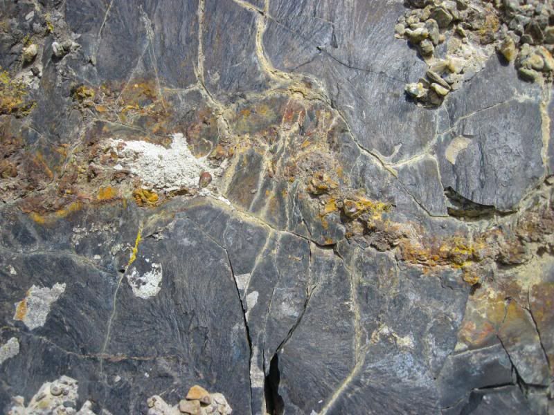

Now, for a few things I've learned about working bedrock.
When checking bedrock, always look very closely at the surface. This means that you have to clear ALL of the material off of it first. Moreover, any clay, and associated material, that is sticking close to the bedrock, carefully save it, so you can pan it out. This means that you'll need some sniping instruments to clean out all the VISIBLE cracks and crevices as well.
Go to a wholesale supply store, a place that sells lots of various hardware/automotive items, to get some things. Several screwdrivers of various sizes is a place to start. Take a slot screwdriver and put it in a vice and bend a couple of inches of the end into an "L". This will make the screwdriver into a little digging/scraping tool: very handy for cleaning out crevices. You might buy an awl as well. Also, if you're in the right type of store, you can buy dental instruments--they come in all kinds of hook and scraping conformations--excellent for getting into very narrow crevices, and they're made of stainless steel so they won't rust, and they're quite tough too.
Buy several sizes of wire brushes, from the small, almost tooth brush sized ones to the larger ones that you'd scrape a wall down to get it ready to paint. You'll need a variety of chisel sizes as well to break open crevices--the good gold goes down deep, and even if the crevice is narrow, it wasn't always that way. I've taken nice nuggets out of crevices that, in their current configuration, were far too narrow at the top to let in the nuggets they held.
This opens up all kinds of theories as to how the nuggets got there, but the key point here to remember is that they ARE there, and who cares how or why they got there. Bust open those crevices until you're sure you're at the bottom, and then really rip up the bottom until you're in solid bedrock--a note on this later.
You can buy tiny little chisels at hobby/automotive stores. You'll need a variety of sizes. You might want to have a few larger chisels as well, and you can buy ones that have a protective shield on them so you don't smash you hands and fingers. So, you'll also need a small sledge--buy a fiberglass handled one--they're much tougher than the wooden handled ones, and the water doesn't affect them. As well, paint all of your sniping tools fluorsecent orange--trust me, you'll leave things lying around, especially when you find some good gold, and it's much easier to spot them later.
You'll need a variety of brushes, from stiff bristles to softer ones as well. Also, you'll need something to sweep your sniping concentrates into. Those little plastic shovels that kids take to the beach work well for tight places, and plastic dust pans work great in larger spaces. A plastic gardening/planting scoop works wonders too. It's also a good idea to have to have a steel one as well--a lot tougher for digging.
Stainless steel spoons of various sizes are handy for digging and for collecting, and sometimes a tough, small plastic spoon can get you into an otherwise inaccessible spot.
An important point, one I alluded to earlier, and this has to do with the bedrock itself, is that after you've cleared all the visible cracks and crevices, and cleared/washed the bedrock, take a very close look at the bedrock to see if you can notice any subtle differences. Also, watch out for a purple stain with any adhereing clay--for whatever the reason, this purple color sometimes indicates hidden crevices and gold.
Moreover, watching for subtle differences is critical. The reason for this is that sometimes, eons ago, the stream was running little bits of material the exact same color as the bedrock. This material, in combination with binding minerals, formed a matrix that cemented in cracks and crevices, and often, gold was already trapped in the crevices. Why bother? The cemented material makes the crevices virtually invisible, but if you look very closely, and if you chip away at any suspicious looking spots, you may discover a hidden crevice. Furthermore, any cemented material should be carefully crushed and panned. I've found a lot of nice gold this way.
Now, the best way to find these obscure crevices is with a detector; if the nuggets are big enough. I've found many a sassy nugget completely hidden in a totally invisible crevice--one cemented so tightly, and invisibly, that I could not tell with my eye that it was there.
In other words, mother nature did a perfect job of hiding that ancient crevice. Not only that, but the matrix is as strong as the host bedrock, and the bedrock will break off with the matrix as you chisel the nuggets out. Always work well to the sides, above or below, the target signal, so you don't damage the nugget as you chisel it out.
This is where it's critical that you have the right detector for the temperature of the bedrock--by temperature I mean that a cool temperature would be a low mineralized bedrock that a VLF would run smoothly on; and by hot I mean bedrock that only a premium Pulse machine will operate on. If your detector just screams and gives up, go borrow or buy one that will run on that bad bedrock as there just may be some pretty little nuggets trapped in invisible crevices.
