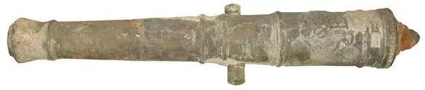

Gentlemen,
I recently saw a bronze VOC cannon that has '989' stamped on the breech area. Do you happen to know what these numbers stand for? See attached photos.
The cannon is 49 inches (125 cm) long and has a bore of 2 inches (5 cm).
Other letters on the breech are partly covered with coral but what I can make out is; STEEN 8 BORC?H ? RDT FUDUN.
Thanks for your help and also for viewing.

Looks close in liking to this English cannon that was found in Indonesia...dates to the early 1700's.
Crab,
No. It doesn't really look like that English cannon. This is a Dutch East India company cannon and the E below the VOC stands for the ENKHUIZEN Chamber in the Netherlands.

The numbers are where you would expect a weight to be. I wonder if the wrong weight was put on- Possibly it should be 289 rather than 989? A pretty identical cannon in the Visser collection- same chamber and makers, same length and calibre- has 294 engraved on it.

I seriously doubt they stamped the wrong numbers there. I have seen a few other (not sure of the year) VOC cannons that had numbers stamps on the breech area and this was the maximum distance (in meters) which the cannon ball could reach at an angle of approx. 45 degrees. If this cannon could shoot 989 meters I would think that they would just mark it as 1,000. Could they be so precise to know that it could fire exactly 989 meters? Seems unlikely, doesn't it? That's why these particular numbers are baffelling to me.

I would not expect of cannon of this date- 1755-1763- to carry any sort of information about distance it shot- I would only expect to find that sort of information in 19th century cannons. What I would expect to find is the weight of the cannon in Dutch pounds- first because of the methods of payment- the VOC would nned to make sure they were not being cheated - and secondly for during its working life. The weight is needed for carriage making and for ship loading. I would be puzzled if there was no weight- hence my suggestion.

Yes, I agree with you that the distance was stamped on the later dated cannons. I also agree that these numbers probably represent the weight of the cannon. I'm just trying to figure out what 989 means. So you think it's 289 dutch pounds?

If there is no other number that can be interpreted as a weight, then yes, that seems a possible explanation.
I assume it has not been altered at a later period?

Actually, when I blow up the photo to max size the 9's do appear to be 2's so you may very well be correct. That makes it 282. Thanks for your great observations. You're a genius!
Now, next question is; How much is 282 dutch pounds compared to US pounds (or in kilograms)?
Tony
After closer evaluation I'm 100% sure it's 282 stamped on the cannon breech. I just read the following on a web site;

Based on the above : 1 Dutch pound = 1.0869 English pounds. So, if I multiply 282 x 1.0869 = 306.5058 pounds.

It's not really damaged. I just didn't look closely enough. When I blow up and look at the original photo's really close I can clearely see that it says 282 (not 989). Anyway, once again I thank you for all your assistance. I do appreciate it very much!

The weapon in your photo would be better described as a PEDRERO due to its short stubby shape.
