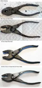

I wanted to try to clean a pair of pliers my wife dug last weekend but did not want to use electrolysis or anything with fumes or caustic acids. I saw Evapo-Rust online and thought I would give it a try. I was not expecting much as it was adverstised as environmental friendly and I have not had a lot of luck with products like that. But i was pleasantly surprised. Here is a series of photos of the pliers from "as dug" , through "simple soap and water wash" to a "16 hour soak" and then an additional "8 hour soak". No scrubbing, just a soak bath and a quick water rinse.
I was pleased with the results.

interesting results!
Been wondering about evaporust. Thanks for the pics & report!
