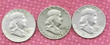

Took my Garrett ace 250 for a run in my local park. Got several dollars in change from recent drops to 4 inches. Meter ID'd coins accurately and of course in the nickel range picked up some trash which I would with more expensive units also. Pinpointing was right on and depth accurate.
12 ID facets was adequate as heck my expensive . If I tried to run the sensitivity near max. did get some bongs as I call them which was sort of like a half belltone.
Unit is well made and is long enough for my 6'2" frame or could easily be handled by a youngster. I found the unit user friendly with my experience, but perhaps a newbie may take a bit to get the hang of it by reading the manual, but shouldn't take long as its all in front of you with the press of a button. Had a slight wobble and would like to see locks on the connectors, but a piece of tape quickly made it solid. At its low price is easily most bang for the buck and has many facets found on expensive detectors. Everyone worries about depth and took it to my test plot and got a dime and nickel at 6 inches and quarter at 8 so it had adequate depth.
In conclusion its a low priced, well made, light, user friendly unit with moderate depth and would serve an old timer or newbie very well.

I love my ACE 250 and after I put my sniper coil on I haven't taken it off yet. I will when I hit a large plantation site next weekend.
With the help of my vibraprobe and minelab digger I can get some decent finds pretty quick in the hunt.
Thanks again Dave and I hope this helps some people learn there yeller feller quicker.
