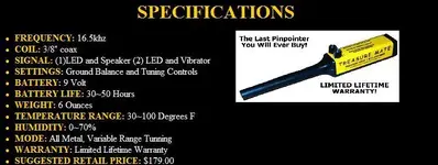

Hea Folks i just located this info on the Net.
