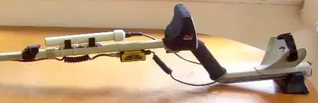

Hey Guys, I have a new (almost) MXT and found a pint jar of clads so far, +
a lot of junk. I bought a Bullseye pinpointer II and think it's pretty good. But I've never seen a Sunray pinpointer anywhere. Is it somewhat like the BE II?
Or is it like I've heard about, one that you can attach to the shaft of your MD, and what's the cost? Also, where could I go to see one (ln TNET that is, or where)? Thanks for any help as the BE II sa one person said only gets out about an inch from the tip. Thanks olegator
olegator01, the Sunray probes mount on the upper shafts of detectors. It is an in-line probe with a little box that has a cable coming out of one end attached to the probe and the other end of the box is where you attach your coil for the detector. It has a little toggle switch which selects between the probe and the coil. It's a great little tool but the one problem I have it forgetting to put it back to coil after I have found the target in question, but I am getting better lately at remember to switch it back. I attached a picture of a detector with the probe attached so you know what everyone is talking about and yes they are worth the $200 purchase price.
