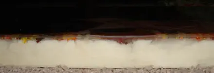

Can you or anyone tell me what the rocks are held together with/how the table top was made. What bonds this into one solid piece, cement, epoxy???
I would like to try to make something like this.

Here are some extra pics to hopefully help you see a little more of it's construction. The table weighs 25 pounds. I did see him making one, and will tell you what I remember. He laid down the top, which in this case is a hard plastic. He had a metal frame he tightened around the top piece, and it was about 2 inches high so he could build the back of the table up in this frame. We know now glass would have been better for the top, plastic tends to crack over time if you are not careful. He then laid the slabs of the rocks face down directly on the plastic top in the same pattern he had laid them out in his shop. He then put broken glass of different color and broken up rock in between the rock slabs to spice it up a little more. He then put epoxy over the back of the slabs and the glass and made sure it mixed in with the glass pieces. This is all I saw, we had to leave his shop, the fumes were making us punchy ;D
You can see from the pics the wood he used to fill most of the back. Hopefully this info and the pictures help a little bit.
