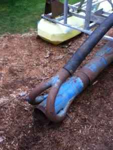

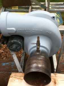

Here's a few pictures of it. The original aluminum pontoons were replaced with plastic ones. From what the guy told, he got it from a friend who had it up in Alaska. I guess he had it sitting in a creek and it flipped over. The engine sat under water for a while and got trashed and the sluice box got washed down the creek.
I'm thinking its a pretty good deal for $500 :laughing7:

Good deal just for the pump and jet alone. I seen that a couple months ago on craigslist just had no use for it and resell is a bad deal right now.
I can tell you why it flipped those floats won't hold the weight of a single big motor they were designed to have two small motors for the 6" and a mini type 8".
Those floats were unstable even with the original set-up. Another lost Keene wonder.
I had seen better deals on 8's over the winter, more complete.

Yea, they even look unstable with that octagon shape. They can roll right over. Im going to be modifying the frame and plan on using the geo engine. I have a lake near my house that I can put it in at and test different set ups to find the most stable platform.
