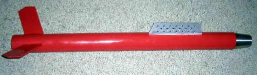

I build some pretty descent tow fishes. Let me know if anyone would like the plans or I could always fab one up for you. They are aluminum and stainless and use either dive planes or weights. Here is a photo.

Jeff, would be interested in having you make me up a towfish. I have made several very rough fish which have worked fine but I like the look of your fish. Could you send plans and cost?
