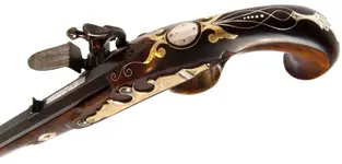

This is a pistol showing a thumb piece, note that it's nailed on.

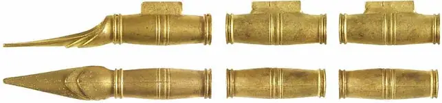

These are ram rod pipes and an entry thimble. The ramrod pipes fit in the groove from the muzzle down to the entry thimble, where the ramrod enters the wood.

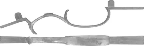

1pipeteiggerguard.webp The trigger guard is also pinned to the stock. The ramrod hole ends at that front flange on the trigger guard. So there is no place between the muzzle and the rear end of the lock for your find to be pinned to the gun, that just leaves the wrist, so to me, and I'm making an educated guess, a swag, it's off an Indian Trade musket as a wrist decoration, and I say that only able to back it up by saying it just looks like it would be on a trade gun. If it isn't the front part of a trigger guard, then in my experience I've never seen anything like it on a long rifle. Perhaps a musket or fowler, probably a trade musket.
