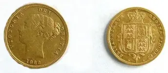

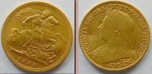

Hey cannonman,after 20 years of detecting i found 2 gold half Sovereigns last year and they were only weeks apart, first one i found at an old farm site and the other one at a race track.
The reading on the MXT was 28 same as pulltabs,so if you want to find gold coins be prepared to dig plenty of pulltabs.
;)Cheers Raoul
