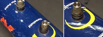

Grazz I can help you after Xmas if you need. My turn around is about one week on a repair, All machines I go thru and check O Rings then do a simple pressure test, Then a pool test of 45 minutes, some I even take out for a hunt myself just to check stability. I use the New Gray Ghost amphibian's setup for the Excalibur, a great improvement over the stock and the Original GGUW's...
One word of Warning to all Excalibur Blue owners, and I need to do a video on this,....... is every blue machine I have worked on and checked under the micro lens has needed the top o-rings replaces. Think I have done about 20 blues in the last few months...everyone needed them replaced. Very simple and I only charge 20 dollars for this...Or I can sell you the O rings to do yourself.....Seems like 99% of the Green machines just need Siliconed greased (Dow Corning 111)
And Sword models have been bad also......A few pics..
View attachment 906927View attachment 906928
