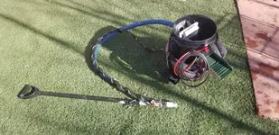

I've searched, but beings as this is my second thread here, perhaps my search fu is weak...
Anyhow, I had an idea for a micro suction dredge since most of my prospecting outside the state of California is done via ultra light back packing. My concept is to run a 12V bilge pump off a LiPo jump pack to suck up fine sands. Nothing bigger than say 1/4". Since the supply would be 1/2", the suction nozzle would be about 1", so that leaves the question of the jet...1/8" or there abouts right? Considering my pump options are limited, what about using a needle valve to give me an adjustable jet? Or maybe brass compression fittings that I can swap out orifices with?
Sometimes I get back into places that are so remote, I'll likely never be there again, so why not process as much material as possible? Any other thoughts? Anybody done something similar?
