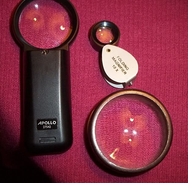

Use camera with cheap magnifying lens over it!
Just get a cheap magnifying lens and put it in front of your camera. Even if it has some scratches on it, it doesn't matter. Focus with the lens held tight to camera and shot.

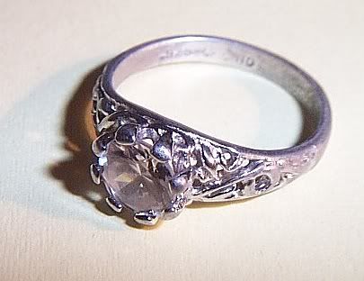

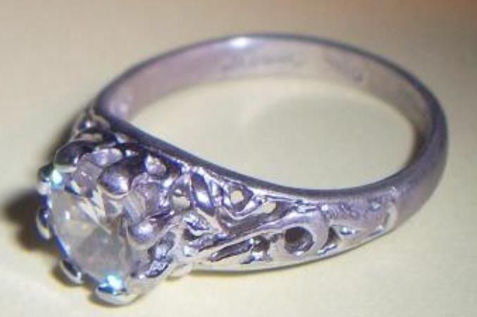

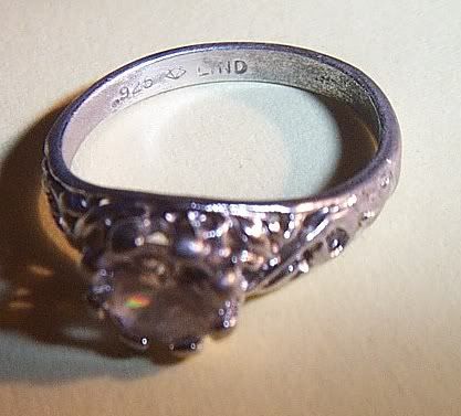

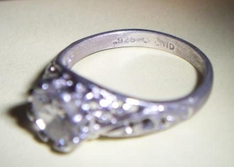

Here are some shots with handheld magnifier over the camera lens. Remember focus with the magnifier added--camera can't automatically compensate for added lens. Experiment, digital film is cheap. lol Notice you can focus on writing or front of ring, if distinction is needed.
Shots are for reference: Normal close up with camera macro settings
New vs older Digital camera for closeups
These two are from new--Xmas 2008--Kodak M753 AF 3x camera with 7.0 Megapixels
These three are taken with older Kodak DX3500 camera with only 2.2 Megapixels

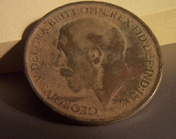

Also good with coins
Reading lamp light source
Large coin leaning on Post-it Note pad

I use my loupe with my camera and get awesome shots on coins and small objects. Magnifying glass is a good idea too, particularly for larger objects. Bryan
