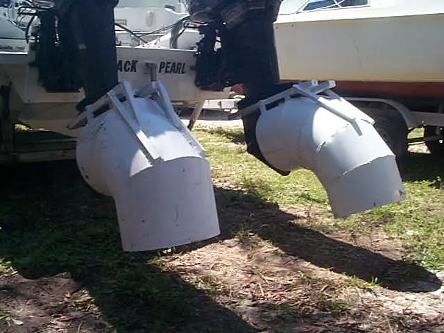

Here is some of Robert Gecy's handy work on a few of our vessels, they are working very well. In your case, if you can buy some pre-made mailboxes, you'll come out much cheaper. We all had a good time building and fitting these on our boats, and Robert is rightfully very proud of them, but they were not cheap when completed. :D

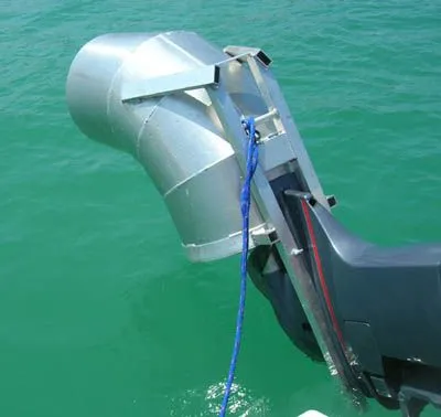

Hey Rio, I think 24" would be too big for an outboard. My mailboxes are for sale for $600- each. They are 16" in diameter.
i need a mailbox for my diesel powered inboard.... also i wouldnt mind buying one of those for my merc... you think it would fit?
My blowers fit the 2.0 litre Merc outboards. Thats the 175, 200 and 225 hp models. What do you have?

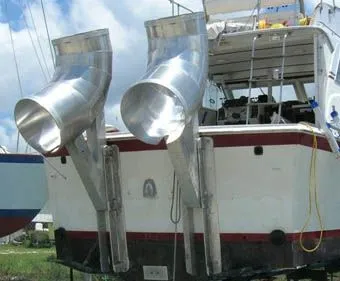

I have plans for a 24" diameter blower tube that would work for your 22" prop. You could have it made from my plans, or my guy here could do it for $1200 (tube only). You would have to do the rest of the fitting to the boat, the braket, mounts, etc.
I think the easiest way is to go the route we did with the Conquistador and use the single arm made from 6x6x1/2" aluminum. Reinforce the walls where the pivot bolts are and maybe even add a bronze bushing. I just added a 1/2" plate to the inside of the 6x6 to make the walls 1" thick and they hold solid as a rock. The transom will need to be reinforced with plywood and/or fiberglass for strength. Luckily the Conq had a thick transom to start with, but we still reinforced it. She will blow with the best of them! No vibration or rattling! We were able to raise the whole back end of the Conq out of the water past the chime without cavitation!

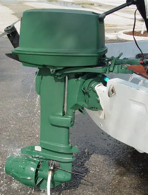

I have a 35hp OMC/evinrude outboard motor jet drive.heres a pic of one like mine.mine is gray.my motor came from a navy seal team in florida.they designed it.couldnt get a pic of mine.its sitting in a engine test barrel.
