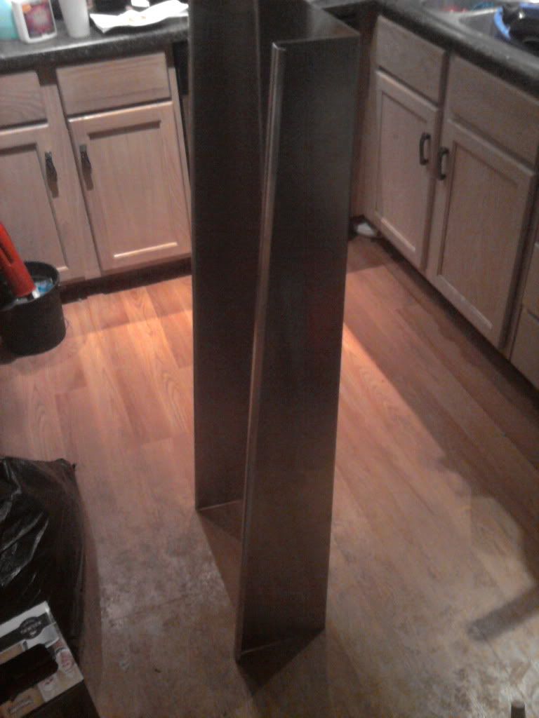

So this year I went out and bought a sheet of aluminum and went to the hanger where I used to work to use the shear and brake and came up with this for my box!!

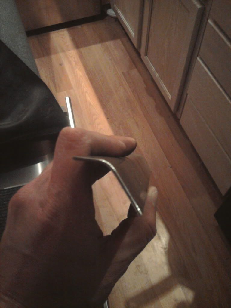

also bent the riffles while I was there too.

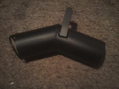

I then went to Les shwab and got 4" exhaust pipe and made a nozzle!!

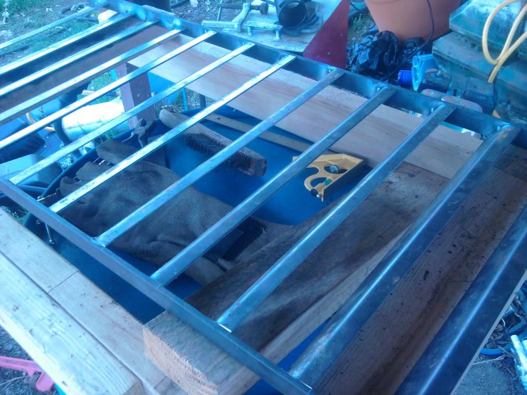

I had to do some modification to the float frame in order to accomodate the flair.
built the top set of riffles.

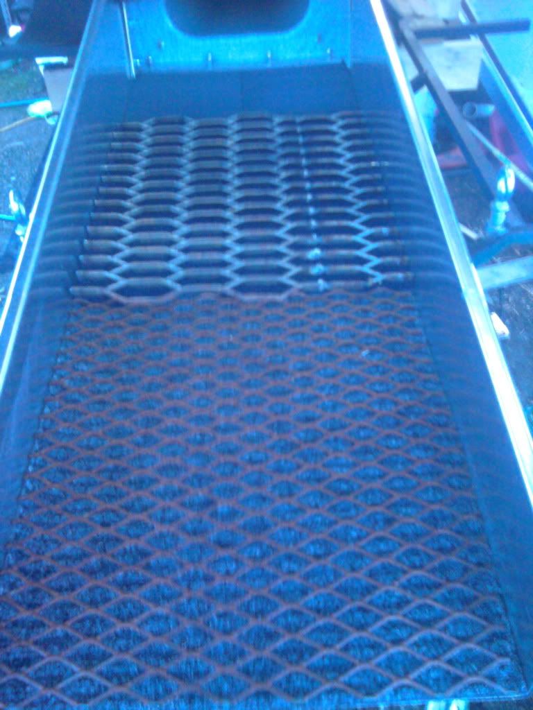

this is the bottom section of the box with deep V mat at the head of it just uner where the punch plate will classify.

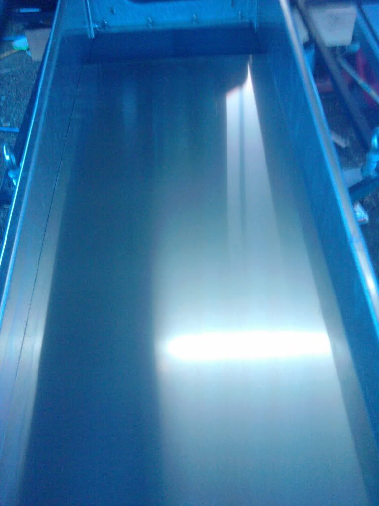

here it is with the false floor in!!
and now with the top set of riffles in!!
I still need to mount the box so that it slides for and aft for angle adjustements and will up date as the project continues!!
Thanks for looking, George
