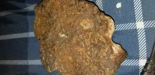

I think its gold or silver anyone wanna guess?

Found this on the floor at a lake looks like a meteorite but not sure 20210727_192323.webp
Limestone and iron or maybe just limestone with some rusty looking lake bottom crud on it.
What evidence do you have that it is gold, silver, or meteorite?
Visually, I would agree with GoDeep. Probably limestone with lake crud.

Of gold why dont you zoom in and look.
Its not a rock at all its completely metallic

I did .. that's why I asked. You said, "I think its gold or silver" and the photo doesn't look like either.

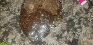

Let it dry, don't wet it and and take it to a well lit area and don't use flash and take multiple high resolution photos.
What we have is dark, grainy pictures with flash reflection off the wet.
Let it dry, don't keep wetting it when taking pictures and making the light reflect off it and take it to a well lit area and don't use flash.

Gold and silver both have high luster while most minerals do not. The water and flash photography make a thing look shinier than it really is. Shine a bright light on a suspected peice of gold or clean silver, then shade the light and if it loses its color it probably ain't a gold or silver.
Also, try to chisel or crush a bit off. If it's metal it will flatten and not flake. But if it does flake then crush it all up and pan it out- you might find something, might not.
Perhaps a bunch of melted metal? Looks to crusty to be gold or silver. Looks like possibly brass melted with some iron stuff. Really hard to say though from the pictures.

Go have it tested , there no way to tell what it is from a photo ....
