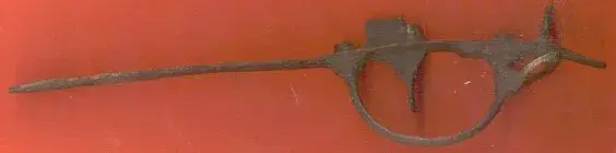

Measure the bore. Is it smooth or rifled? How long is the barrel? Note the shape of the buttplate ( I think the trigger tang is bent, but note it's length.) It seems to have only one barrel band (unless you didn't find the other/s) and a metal forend cap. Compare this data with rifles/ muskets you would expect to find at that location.

From the bend in the tang and the slight bend in the barrel in the same direction, I would say that it ended it's career wrapped around someones head in close combat.

OK, Here we go. After looking over a bunch of rifles, I found it to be possibly a Enfield Rifle.
J.S. Anchor- marked Enfield Artillary.
Imported from Great Britain est. 1861.
Later some of these rifles were converted to carbines and also barrels had 3 groove rifling added.
I hope this of some help. Being that it was found in Alabama, it told me that it was Confederate.
Looking at Confederate rifles used back then, this is what I found
Most Likley An Enfield. trk5capt...
