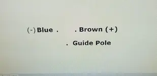

I DE-Soldered the Wires on my Excalibur,where they entered the Ilklite Fitting on the Battery end.Inside that Chrome Nut.I was repairing the Cable,which had some Rot just as it enters the Chrome Nut.I failed to take notice of the Polarity at the Solder Joints.One Wire is Blue,and the other is Brown.Looking at it as if it were a Clock Face,with the "Alignment Pin" Hole at 6 o'clock,the Solder points are at 9 O'clock and 3 O'clock.Any help would be greatly appreciated.Thanks.Ken
Here is info that I have, this is the way all 4 of mine are wired. Picture is looking at the ikelite connector that plugs into the battery pod from the top looking down at it, guide pole to the bottom. Left pin is negative and blue, right pin is positive and brown.

I did'nt quite understand when you said "looking down from the Top" Does this look correct??
Thanks a lot,I appreciate the help.Ken.
