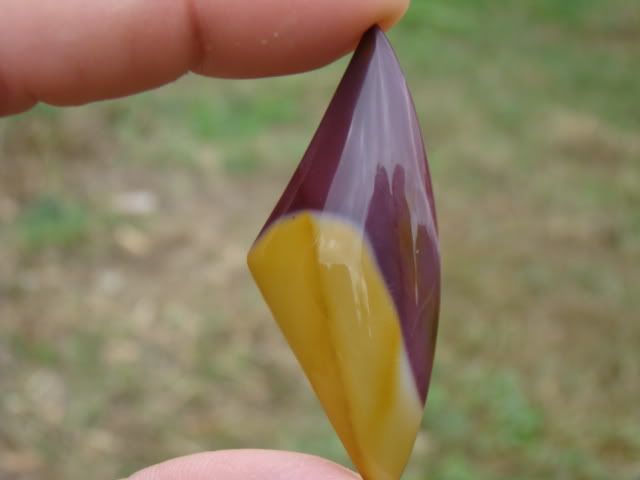

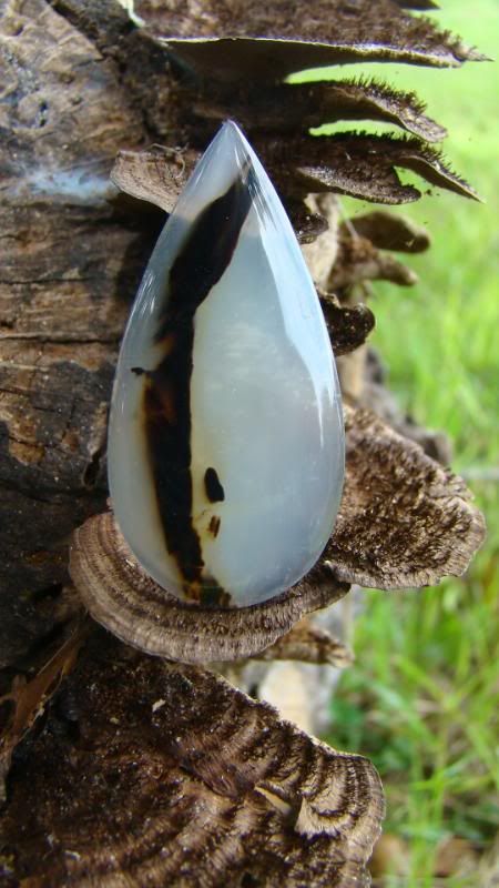

thanks for the reply cfdigger, i think mine is an old 6" star diamond brand combo trim saw with100 and 220 grit wheel, and expandable wheel i use different grit sanding belts. a seperate buffer and a 14" slab saw. buffer runs about 3500 rpm's, is that too fast? nice pics. of your work.
