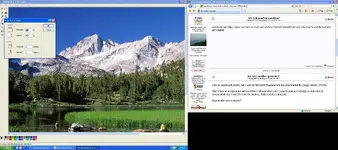

I use paint to make picture size small enough to upload on forum , screen shot of buttons
