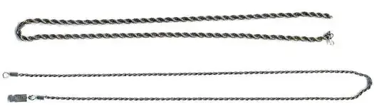

Found these two necklaces a while ago but i am not sure they are gold one says 14k Italy iam almost posotive that one is gold but the other one only has USA written on it, it was a lucky find cause i was just cleaning up the side of a shed that had a lot of trash i started diggin and out they popped, i took them to a dealer and u wouldent believe what he did, he picked them up smelled one and then the other, my freind asked y do u that? he said that gold has a certain smell and these dont have that smell!!!! grrrrrr he said they wernt gold then said that if they were gold hed give me $50 for one! BOOOO! i think he said that cause i said that i didt want to sell em, anyways? just wanted to see if any of u guys think they are gold, HH CoinS (golddigger)

take them to a pawn shop. Most pawn shops have test devices that will let them know if its gold. An honest pawn shop will take it right to the tester instead of smelling it!
PPPssshhhh yeah right,ANY local pawn shop will tell you down to what karat it is.Go in,ask 'em how much they'll give you for it as scrap gold, then x's that by at least 5,then you'll know what it's worth.Good luck and H.H.
Something smells and it aint gold! Any legit place will tell you what is real or faux. Cladius.
I was told by a jeweler that gold doesn't have a smell, brass does. He said if you can smell a smell it is brass or some other metal, not gold.
copper, a common alloy, does have an odor as it oxidizes.
copper is commonly alloyed with gold among others.? simple test -----
