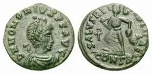

That is an AE4 of Honorius.
Obverse Legend: DN HONORIVS PF AVG
Reverse Legend: SALVS REI-PVBLICAE
The reverse pictures the personification of Victory advancing Left holding a trophy over her right shoulder and dragging a captive by the hair.
I'd judge the style to be from Antioch although the coin could also be from Cyzicus or Constantinople per R.I.C. (Roman Imperial Coinage) reference. I'll attach a picture of a nice example from Constantinople (note the difference in style from your coin).

I would also add to gunners description that it has Chi-Rho symbol in the field. (in front of Victory)
The Chi-Rho symbol is an anagram of the first two letters of Christ in Greek, the Chi (our CH) and the Rho (our R). These two letters written together stand for Christianity in the Late Roman Period.
