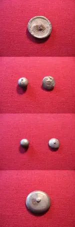

When I recently saw a friends artifact collection, he had buttons from the 17th century (1600's) that were rather crude on one side but were fairly nice on the outward side and the name for the type of button is called a "nipple button".
Here is a photo of one of the ones he has found. If you goggle search nipple button 17th century you will find a site or two with another photo of this type of 17th century button.
Anyway, a food for thought on a possible answer.

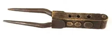

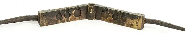

I think that's probably the best evidence that it has some purpose other than as a casting mold. If it were for casting, it should be level, not curved. Otherwise, if more than one or two buttons were being cast at a time, those near the ends would be thinner on one edge. Also, the shapes appear rather irregular for buttons. Here's a typical early 1800's button mold:

The buttons you have above are more commonly called "Pimple" Buttons & are indeed 17th century. The ones pictured were often used on English Civil War jackets. "Nipple" is more of a slang name given to them.
As detailed in Gordon Baileys book - "Buttons & Fasteners"
Re: 1700's Mold - For What?
Got the term from Colchester's metal detecting finds site :)
